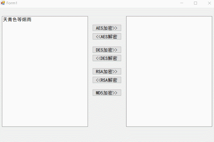

    private void btn_Aes_Encrypt_Click(object sender, EventArgs e)        {          string result= AesUtil.Encrypt(textBox1.Text, "12345678900987654321");          textBox2.Text = result;        }
private void btn_Aes_Decrypt_Click(object sender, EventArgs e) { string result = AesUtil.Decrypt(textBox2.Text, "12345678900987654321"); textBox1.Text = result; }
实现效果:
