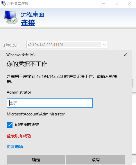

2、配置frpc.ini文件并启动(需要映射到外网出去的内网主机)
[common]
#1、你frp服务器的公网ip地址
server_addr = 42.194.142.223
#2、你frp服务器的通信端口,默认是7000,如果你服务器端改了,这里也要跟着改
server_port = 10010
# 转发多个端口
[ssh]
#3、协议类tcp/udp
type = tcp
#4、你当前内网服务器的网卡IP地址,不要用127.0.0.1
1oca1_ip = 192.168.0.109
#5、你要转发的服务端口(远程端口:3389;ssh:22)
local_port = 22
#6、你要映射到公网上的那个端口
remote_port = 11100
[mstsc]
type = tcp
local_port = 3389
remote_port = 11101
[http]
type = http
local_port = 5200
remote_port = 11102
custom_domains = 42.194.142.223
[tcp01]
type = tcp
local_port = 11103
remote_port = 11103
[range:tcp]
type = tcp
local_port = 11104,11105,11106
remote_port = 11104,11105,11106
#7、服务器与客户机之间的心跳连接: 如果没有,每隔60秒就会自动断开连接!!
heartbeat_timeout = 30
启动
D:\Program_Files\frp_0.47.0_windows_amd64\client>frpc.exe -c frpc.ini
2023/03/29 12:36:26 [I] [service.go:299] [de12e81d53b4342f] login to server success, get run id [de12e81d53b4342f], server udp port [0]
2023/03/29 12:36:26 [I] [proxy_manager.go:142] [de12e81d53b4342f] proxy added: [mstsc http tcp01 ssh]
2023/03/29 12:36:26 [I] [control.go:172] [de12e81d53b4342f] [tcp01] start proxy success
2023/03/29 12:36:26 [I] [control.go:172] [de12e81d53b4342f] [ssh] start proxy success
2023/03/29 12:36:26 [I] [control.go:172] [de12e81d53b4342f] [mstsc] start proxy success
2023/03/29 12:36:26 [I] [control.go:172] [de12e81d53b4342f] [http] start proxy success
测试
ssh,远程连接,http访问,tcp连接
