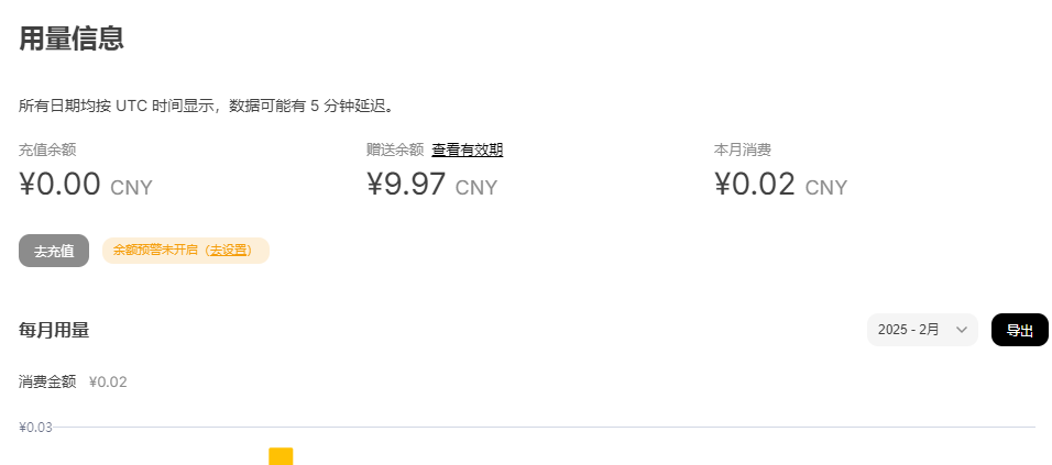

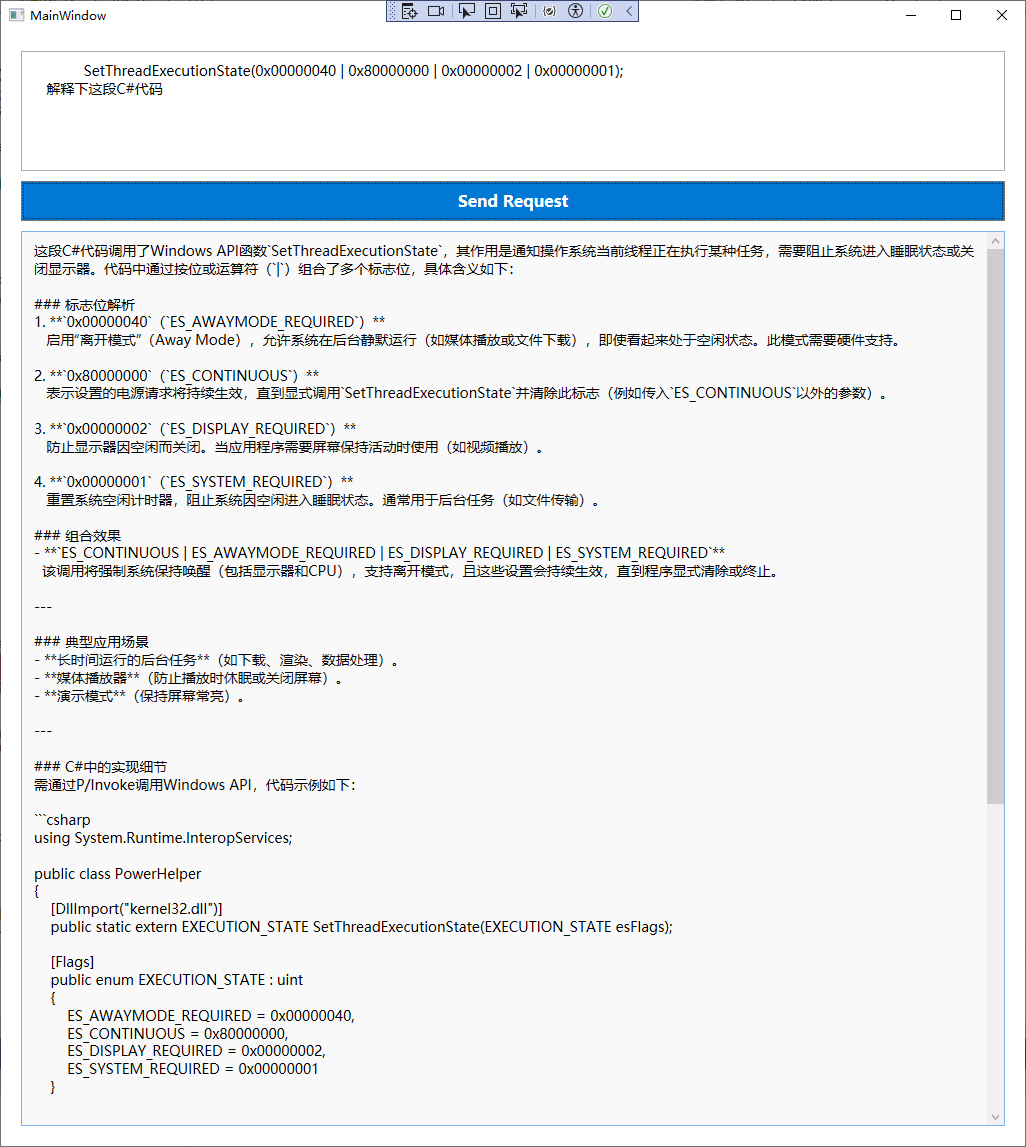

先上图,结果如图
先去官方网站充值api费用,默认
对应的C#代码封装

调用示例
   private async void SendButton_Click(object sender, RoutedEventArgs e)
       string requestText = RequestTextBox.Text;
       if (!string.IsNullOrWhiteSpace(requestText))
           try
               string responseData = await DeepSeekHelper.CallDeepSeekAPI(requestText); // await new DeepSeekApi().CallDeepSeekAPI(chatRequest);
               ResponseTextBox.Text = responseData;
           catch (Exception ex)
               ResponseTextBox.Text = $"Error: {ex.Message}";
       else
           MessageBox.Show("Please enter a request.");
