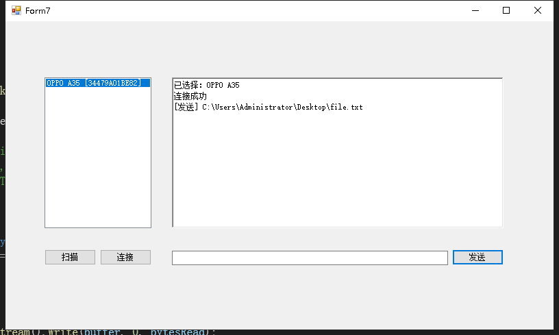

一、效果展示

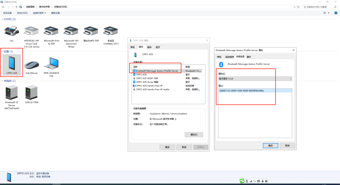

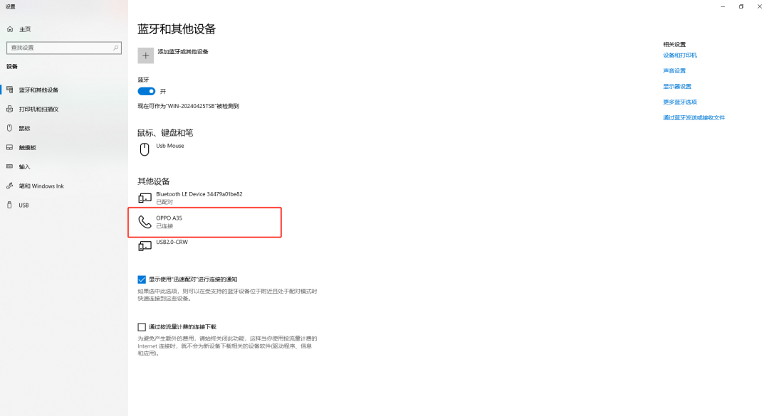

三、电脑开启蓝牙功能

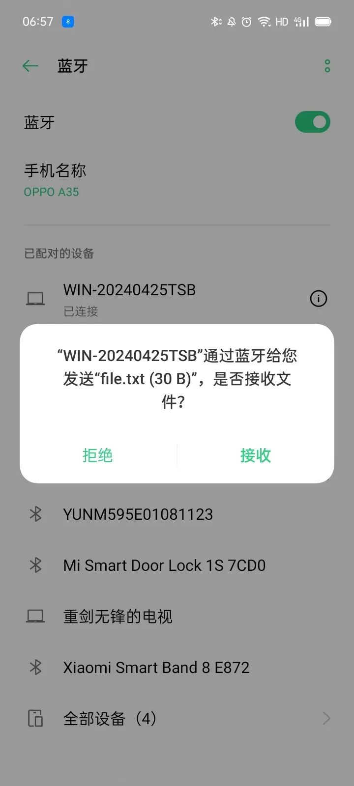

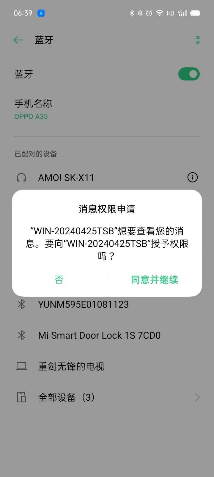

手机接收到蓝牙连接
手机接收到蓝牙文件

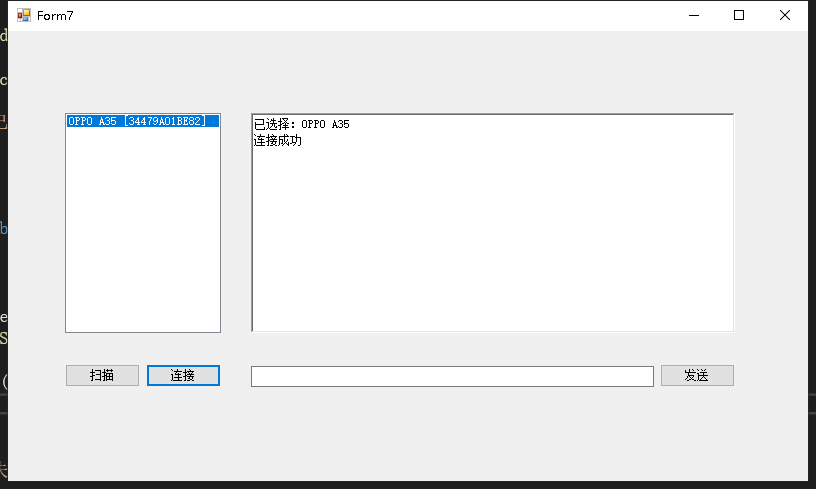

    建立连接
      private BluetoothClient btClient;private NetworkStream btStream;private BluetoothDeviceInfo selectedDevice;private readonly Guid serviceUUID = new Guid("00001132-0000-1000-8000-00805f9b34fb"); // 标准SPP服务
      // 扫描蓝牙设备private void btnScan_Click(object sender, EventArgs e){ lstDevices.Items.Clear(); btClient = new BluetoothClient(); var devices = btClient.DiscoverDevices();
      foreach (var device in devices) { lstDevices.Items.Add($"{device.DeviceName} [{device.DeviceAddress}]"); }}
      // 设备选择private void lstDevices_SelectedIndexChanged(object sender, EventArgs e){ var selected = btClient.DiscoverDevices()[lstDevices.SelectedIndex]; selectedDevice = selected; richTextBox1.AppendText($"已选择:{selected.DeviceName}\n");}
      // 建立连接private void btnConnect_Click(object sender, EventArgs e){ try { btClient.Connect(selectedDevice.DeviceAddress, serviceUUID); btStream = btClient.GetStream(); StartListening(); richTextBox1.AppendText("连接成功\n"); } catch (Exception ex) { MessageBox.Show($"连接失败:{ex.Message}"); }}

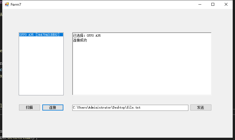

        发送数据
          // 发送数据private void btnSend_Click(object sender, EventArgs e){	if (btClient?.Connected != truereturn;	// 读取文件并发送	byte[] buffer = new byte[1024]; // 缓冲区大小可以根据需要调整	using (FileStream fs = new FileStream(txtSend.Text, FileMode.Open, FileAccess.Read))	{		int bytesRead;		while ((bytesRead = fs.Read(buffer, 0, buffer.Length)) > 0)		{			btClient.GetStream().Write(buffer, 0, bytesRead);		}	}	richTextBox1.AppendText($"[发送] {txtSend.Text}\n");	txtSend.Clear();}
