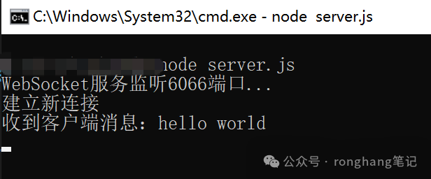

验证
  1. 安装依赖包 npm install ws
  2. 搭建WebSocket服务,server.js:
    const { Server } = require("ws");
    const server = new Server({ port: 6066 });
    console.log("WebSocket服务监听6066端口...");
    server.on("connection", (client) => {
      console.log("建立新连接");
      client.on("message", (msg) => {
        console.log("收到客户端消息:%s", msg);
        // 给客户端发送消息
        client.send(Math.random());
      client.on("close", () => {
        console.log("与客户端的连接断开");
  3. 启动服务 node server.js
  4. WebSocket客户端,client.js:
    const WebSocket = require("ws");
    // WebSocket连接nginx代理服务器192.168.1.18
    const socket = new WebSocket("ws://192.168.1.18:6066/");
    socket.on("open", () => {
      console.log("与WebSocket服务端连接成功");
      socket.send("hello world");
    socket.on("message", (data) => {
      console.log("收到消息:" + data.toString());
    socket.on("close", () => {
      console.log("WebSocket关闭");
    socket.on("error", (err) => {
      console.error("WebSocket错误:", err);
  5. 启动客户端,node client.js
