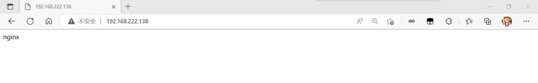

LISTEN     0128                      [::]:22                     [::]:*
访问:

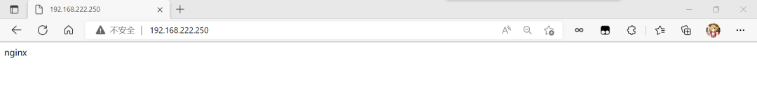

测试:
在浏览器输入nginx负载均衡器的IP地址

访问:

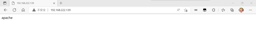

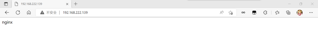

测试:

访问:

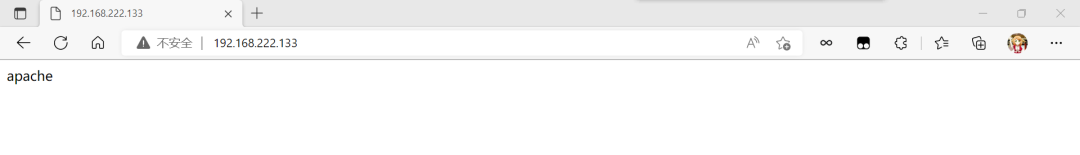

访问:
master:
[root@master keepalived]# curl 192.168.222.133
apache
nginx

[root@backup keepalived]# curl 192.168.222.133
apache
nginx
访问:
可以看到,其中一个nginx负载均衡器挂掉了,也不会影响正常访问,这就是nginx负载均衡的高可用的配置

关闭master的nginx
[root@master~]# systemctl stop nginx.service
[root@master~]# ss -antl
State      Recv-Q     Send-Q          Local Address:Port           Peer Address:Port     Process
LISTEN     01280.0.0.0:220.0.0.0:*
[root@master~]# ip a
1: lo: <LOOPBACK,UP,LOWER_UP> mtu 65536 qdisc noqueue state UNKNOWNgroupdefault qlen 1000
    link/loopback 00:00:00:00:00:00 brd 00:00:00:00:00:00
    inet 127.0.0.1/8scope host lo
       valid_lft forever preferred_lft forever
    inet6 ::1/128scope host
2: ens33: <BROADCAST,MULTICAST,UP,LOWER_UP> mtu 1500 qdisc fq_codel state UP groupdefault qlen 1000
    link/ether 00:0c:29:05:f4:28 brd ff:ff:ff:ff:ff:ff
    inet 192.168.222.250/24 brd 192.168.222.255scopeglobal noprefixroute ens33
//没有VIP
backup:
[root@backup~]# ip a
    link/ether 00:0c:29:31:af:f9 brd ff:ff:ff:ff:ff:ff
    inet 192.168.222.139/24 brd 192.168.222.255scopeglobal noprefixroute ens33
    inet 192.168.222.133/32scopeglobal ens33
    inet6 fe80::20c:29ff:fe31:aff9/64scope link
[root@backup~]# curl 192.168.222.133
apache
nginx
//备节点变成主机节点
重新开启master的nginx
[root@master~]# systemctl restart keepalived.service
[root@master~]# systemctl restart nginx.service
    link/ether 00:0c:29:f6:83:57 brd ff:ff:ff:ff:ff:ff
    inet6 fe80::20c:29ff:fef6:8357/64scope link
[root@master]# curl 192.168.222.133
apache
nginx
//此时VIP重新回到master上面
链接:https://www.cnblogs.com/tushanbu/p/16804805.html
