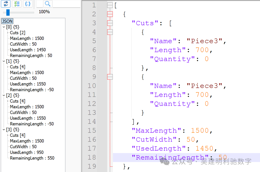

文件驱动主程序
using System.Text.Json;
class Program
    static void Main()
        string inputPath = "job.json";
        string outputFFD = "output_ffd.json";
        string outputBFD = "output_bfd.json";
        Job job = JsonSerializer.Deserialize<Job>(File.ReadAllText(inputPath));
        var ffdStocks = SolveFFD(job);
        var bfdStocks = SolveBFD(job);
        File.WriteAllText(outputFFD, JsonSerializer.Serialize(ffdStocks, new JsonSerializerOptions { WriteIndented = true }));
        File.WriteAllText(outputBFD, JsonSerializer.Serialize(bfdStocks, new JsonSerializerOptions { WriteIndented = true }));
        Console.WriteLine("FFD 和 BFD 求解完成,输出已生成。");

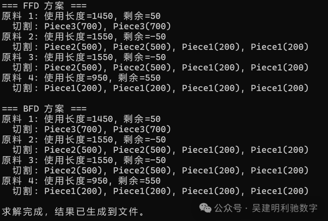

输入示例 (job.json)
  "MaxLength":1500,
  "CutWidth":50,
  "TargetSizes":[
    {"Name":"片段1","Length":200,"Quantity":8},
    {"Name":"片段2","Length":500,"Quantity":4},
    {"Name":"片段3","Length":700,"Quantity":2}
输出
